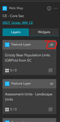

I poked around and discovered that you can add a source map to Data multiple times, and then set layer visibility from there:
With that, you can use multiple views + map widgets to display themes without any dependency on extent.
However, I think that being able to do this type of workflow with bookmarks would be a lot cleaner, particularly as it would allow you to everything on one map widget and be a little less cluttered on the backend. But, I am happy that I don't have to make 7 different source maps!
