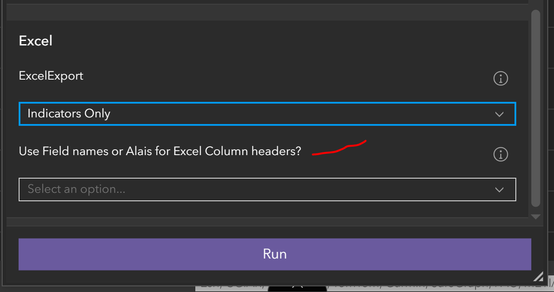

Need a way to hide some parameters when they are not relevant.  Works in Pro but not seeing it work in ExB analysis widget.  I mostly want enabled so I can turn some off params but not sure if other things work or not?  One tool I limit to 1 polygon selected for example.
def updateParameters(self):
        # Modify the values and properties of parameters before internal
        # validation is performed.
        if self.params[2].value:
            self.params[3].enabled = True
        else:
            self.params[3].enabled = False
        return
thanks
