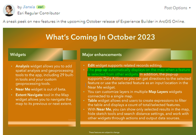

PatOBrien
To be implemented within ArcGIS Online:
https://community.esri.com/t5/arcgis-experience-builder-blog/what-s-coming-in-october-2023/ba-p/1336...
Will be a while till we see it within ArcGIS Enterprise though!
DavidWittmann
Thanks for linking me to the post, @PatOBrien! If you use the ArcGIS Experience Builder (Developer Edition) you should be able to use these features in your Enterprise as soon as they get released.

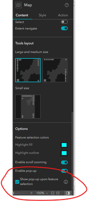

SamJakson
Anyone got this working? I have a list in an experience and the pop up in the map still isn't opening when selected.
JeffreyThompson2
@SamJakson You need to explicitly enable this option. It's all the way at the bottom of the map settings, so it is pretty easy to miss.
Also, there is a major bug with this feature, so it may not work for you anyway.
SamJakson
@JeffreyThompson2 ah amazing thank you, that was very hidden away! Seems to be working for me now.
