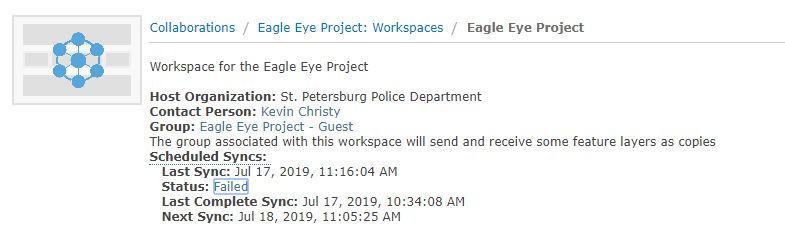

On the guest Portal side, I add the copied layer to a web map and enable the refresh interval. I then go back to my host AGOL environment and fill out another survey to add a record. The hosted feature layer on the AGOL side is immediately updated without issue. I then go back into the guest Portal side, and schedule the sync for the workspaces to occur within the next two mins or so. I am simply testing to see if the feature layer updates properly at sync...
It does not.
I get the following screen message:

And to top it all off I get a notification on my AGOL site that "The hosted feature layer could not be sent as a copy, so it was sent as a reference instead."
Now, my nice original hosted feature layer copy seems to have lost some of its functionality and has not updated.
