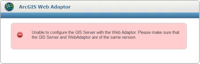

When it comes time to register the WA with Server, I am getting the following error:
Has anyone experienced this issue?   I have installed the WA since 10.3.1, and 10.4, a few times, but never had this issue.
I have tried, uninstalling/reinstalling, make sure I have all the necessary IIS requirements, etc. Nothing seems to be amiss.

Closer scrutiny has revelled that, my server installation was actually 10.4, and not 10.4.1.  I must have clicked the wrong install file, given that both 10.4 and 10.4.1 coexisted in the same directory location.
So the learning points here:  The WA identifies correctly when it is being register with a version that does not correspond to it.
