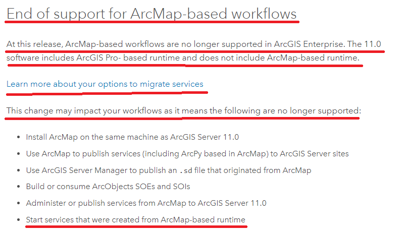

@ChristopherBowering - You might have to republish your services using ArcGIS Pro, see the documentation below.
What's new in ArcGIS Enterprise 11.0—ArcGIS Enterprise | Documentation for ArcGIS Enterprise
Migrating services to the ArcGIS Pro service runtime—ArcGIS Server | Documentation for ArcGIS Enterp...
Client and geodatabase compatibility—ArcGIS Server | Documentation for ArcGIS Enterprise
