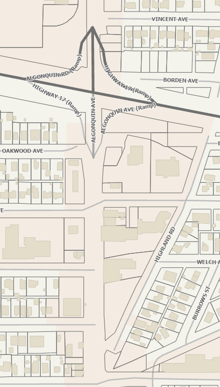

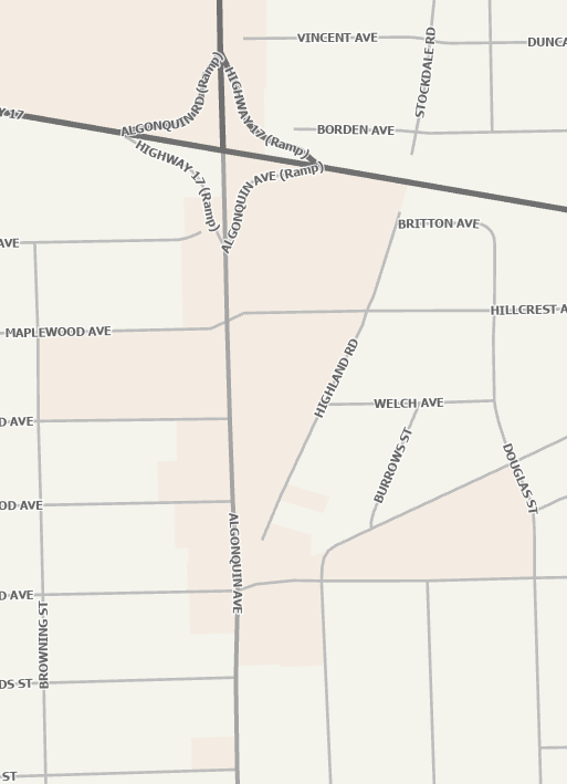

I've been testing an application our team has been developing in Experience Builder. In this application we have various layers from parcels to building footprints to road sections. To test without needing to migrate all our source data to Enterprise, I've just been sharing as web layers to our Portal from Pro. When I get the layers ready and go to share them, the display looks fine in Pro. However as soon as I open the layer in MapViewer in Enterprise, for our road sections, half the road sections do not display and are just gone. Can't select, query, or search for any of the features that decided not to display. As if they've just been completely removed from the feature.
Is there some sort of issue when I am sharing? Our parcels all seem to export properly. This is extremely frustrating. Not sure if anyone else has run into this but I need to find a solution so half my city's roads don't disappear in Portal. Some sort of limit on the number of line features that can exist in a hosted feature layer or map image layer? See images below of what is seen in Pro vs MapViewer.
