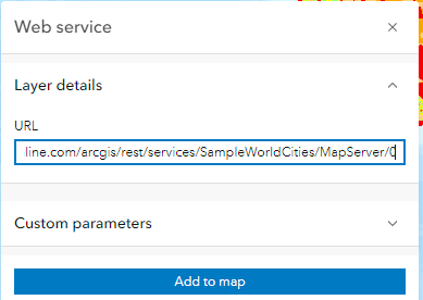

Shared instance or not, I'd not enable Feature Access if there is no need for editing. There are cases when you might want to take advantage of client side drawing or interactivity, you can still add a layer from a map service as a feature layer. As you know for that all you'd need to do is use a URL that ends with /0 e.g. https://sampleserver6.arcgisonline.com/arcgis/rest/services/SampleWorldCities/MapServer/0

Map Server derived Feature Layer: you have to know and add the full MapServer/0 layer id rest URL using Add > Web Service method
