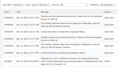

Besides all this, we are seeing continuous ArcGIS Datastore replication failures from standby datastore. By any chance this can trigger an outage for 30-40 minutes?

Regarding the Data Store, I don't think that should cause an ArcGIS Server outage. That should only cause an issue with the Data Store itself.
