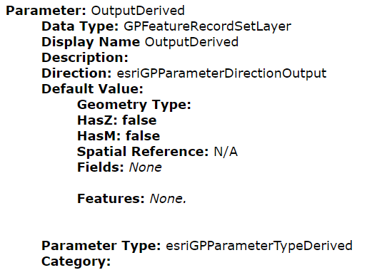

This is the REST URL for my geoprocessing service: WetlandPrioritization/WetlandPrioritizationTool_Ac (GPServer), and the screen shot below show my output parameter as having no geometry type.
Question 1) Does anybody know why I cannot see the geometry type? I am assuming this is the reason I cannot add my result as an operational layer.
Question 2) I am assuming the error above is why the tool will not run. But I also realized that I am using the python math module in my python script....Is that a problem? Do I need to download that module somehow onto my server, or can I assume the math module will work in the gp service?

When you ran the GP tool in ArcMap, were the results added to the display? Did the output show a proper geometry symbol?
Ex.
Generally, how it behaves in ArcMap is how it'll behave as a service. I'd say the problem is definitely that the Geometry Type is null.
This isn't related to the math module, as you'd see an ImportError when running it on the Server. Can you upload the toolbox?

Oh whoops I was looking at the wrong thing. The output actually did not show a proper geometry symbol when I ran it in ArcMap.
JonathanQuinn
Esri Notable Contributor
Ok, that's why the service doesn't have geometry. Can you try to republish the service with the output parameter as a Feature Set, instead of a Feature Class? Theoretically, they should be the same, but that's a simple test to run. If that doesn't work, can you upload a sample input as well as parameter values I can use to try it out?

Alright so it didn't work as a Feature Set, but then when I specified the output in the script tool parameters as Feature Layer, and also specified that the derived output was obtained from the output layer, it worked! It showed the proper geometry symbol in ArcMap when I ran it and when I used the geoprocessing service in Web AppBuilder the tool did not have any issues with the geometry type either! It let me change the default symbology and everything. It still doesn't work haha, but the geometry issue is solved now
