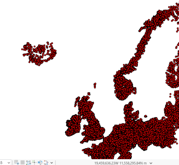

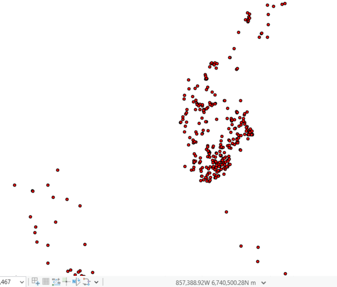

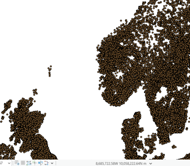

The dataset when rendered correctlyThe dataset when rendered correctlyZoomed in (A lot of points are missing)Zoomed in (A lot of points are missing)Zoomed out version( more points but still many missing)Zoomed out version( more points but still many missing)
