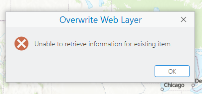

Error Message from ArcGIS Pro:
ArcGIS Pro error messageArcGIS Pro error message

Hi @moremeowbell hope you are well.
You might have checked this, but if you didn't it's worth checking:
https://support.esri.com/en-us/knowledge-base/error-unable-to-retrieve-the-information-for-existing-...
Let me know if it works🤩
codethemap
You can try:
1. If overwrite is blocked due to source mismatch: Re-publish the Service as New
2. If you must overwrite: Recreate the database connection (.sde) using the exact same name and credentials as used in the old environment. (Ensure the database is registered with the new ArcGIS Server using this connection)
Few Checks:
-> Confirm ArcGIS Pro is signed into the correct Portal
-> Make sure the service is still hosted on the same federated server in the new environment.
-> Ensure SSL/TLS, proxy, or firewall settings aren't blocking access to the new DB.
