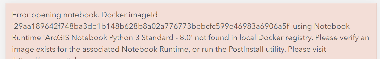

Running ArcGIS Enterprise 11.1 on Windows, Notebook Server is using Linux containers and a standard license. I have ran through all the pre-reqs - docker desktop w/ linux contains and hyper-v, downloaded linux images from MyEsri, and installed using the postinstallutiltiy.bat which succeeded.
Running docker image ls on my notebook server returns the following:
When attempting to open any notebook I get this error. When I try to validate the standard runtime through notebook/admin, runtimeexists is false.

tigerwoulds
Hey Tim, thanks for the response. I did confirm Image ID matches and used the same container download from your screenshot (those are infact linux container images). I ended up resolving the issue by going to Notebook Server Admin > System > Properties and setting the useWindowsContainers property to false. I then went to Notebook > Runtimes and restored the factory runtimes. We're running Windows Server 2022 and these additional steps are required.
