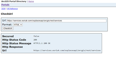

@JonasNeubürger For future reference, there is a tool in Portal which can be used to let you know the response that Portal is receiving, it's called the checkURL tool. Here's how you use it:
CheckURL via Portal:
  1. Navigate to /portal/sharing/rest to access the Portal directory. This may be disabled, in which case you will need to follow this documentation to allow this. This can be disabled once you're finished with the Portal directory. https://enterprise.arcgis.com/en/portal/latest/administer/windows/disabling-the-arcgis-portal-direct...
  1. Login (button is in the top right) and then select Home.
  2. From here, select Portals and then select "CheckURL"
  3. Provide a URL for the tool and select run. You should expect to see a 200 response:
Keep in mind that any secured pages may return a 403 (forbidden error) due to the need to login.

I did try that, but got a 200 status code just like you, with secured=false (and a 403 when I used a private window, where I was not authenticated). That's also why I was confused about it not working.
