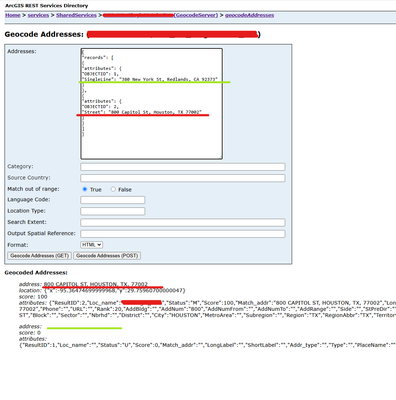

We have a 10.9.1 Standalone Server. Published a composite locator created and published from ArcGIS Pro 3.3.1.
The issue we are trying to debug is with /rest/services/Test_Locators/Locatortest/GeocodeServer/geocodeAddresses call when trying to use SingleLine JSON Input.
We cannot search address if the JSON is with "SingleLine": "380 New York St, Redlands, CA 92373" input.
It works if we use "Street": "380 New York St, Redlands, CA 92373" as JSON input, which is not correct as per ESRI docs.

The same Composite Locator works with SingleLine inputs on 11.4 Enterprise Env.
