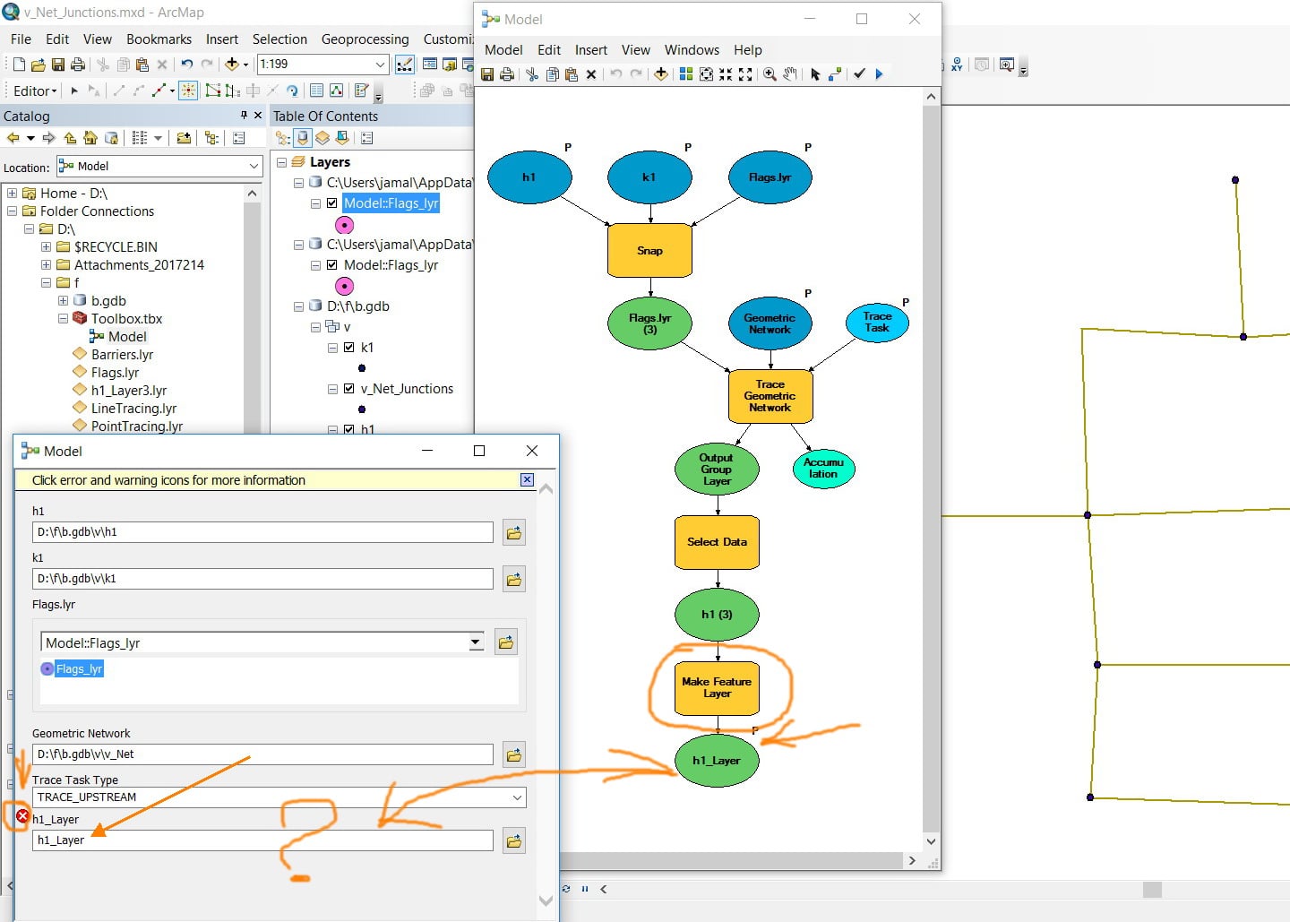

As per the screenshot below, each time I run the model by opening it, I got an output error for the “make feature layer” tool. How come the ArcMap says that the layer is already exist while the output of the “make feature layer” tool is supposed to be on the fly?
Is there a way to avoid such error and thus not asked to change the name of the output to have the model run successfully?

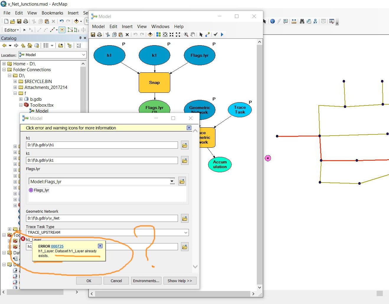

I’m still having a warning despite the fact that I have checked the “overwrite the output…” option as shown in the screenshot below
How this warning might be eliminated?

that is just a warning, not an error, there is no modelbuilder tool to supress warnings

The Overwrite the outputs of geoprocessing operations check box controls whether tools automatically overwrite any existing output when run. When it is checked, you receive a warning before tool execution that the output exists, but the tool executes and overwrites the output dataset. With this option off, existing outputs are not overwritten, and the tool displays an error, preventing you from executing the tool.
