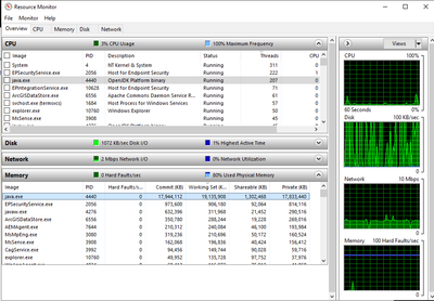

NatC42
Hi @MoMahmoud.... We've been having issues with our hosting server logging database connection issues with our ArcGIS Data Store on another machine.  That machine is a Windows Server 2019 with 32GB Memory and 25GB Memory is constantly eaten up by the java.exe for the OpenJDK Platform binary.
Do we really need to double the memory on the server to account for this java application or can we mitigate the issue another way?
Attached is a screen shot of the Server Resources...
