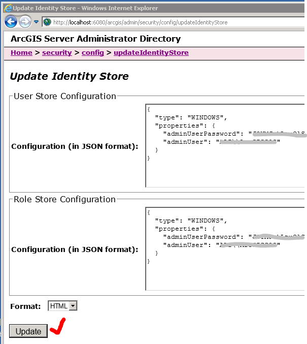

Later, I went into the ArcGIS Server Administrator tool (http://localhost:6080/arcgis/admin/security/config/updateIdentityStore) to see if there was a problem with the accout information that we have for the identity store.  The only button at the bottom of the page is the UPDATE button.  I clicked it... THAT WAS A BIG MISTAKE!
I noticed that after hitting the update button, the value for adminUserPassword appeared to change. Pressing update again gave me this error:  "Failed to update the identity store configuration. Could not configure the identity store as one or more of the supplied parameters is incorrect. Verify that you can connect to the identity store outside of ArcGIS Server using the same parameters."
Now everytime that I try to start ArcGIS Server in our TEST environment, it locks the network account that we use for identity store.  So essentially I have had to shut down our TEST environment until I can get this fixed.

Update:  I worked with Dennis from ESRI to resolve this issue.  The answer is "YES" you can modify the config file located here:  ..\arcgisserver\config-store\security\security-config.json
To be safe, please make a backup of that file before modifying it.  I entered the password in clear text and saved the config file.  Then I started the Windows Service: ArcGIS Server.  When the ArcGIS Server was up and running, I was able to go into the admin tool again.  I went to this address: http://localhost:6080/arcgis/admin/security/config/updateIdentityStore
The password was still in clear text (which is not what you want).  So I hit the update button again and it re-encrypted the password.  All done, all working again.  Thanks Dennis at ESRI!
