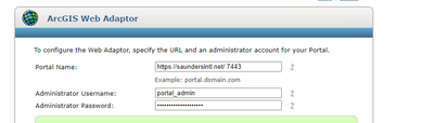

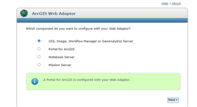

have you configured them like this
ArcGIS Server
ArcGIS for portal
  • You can make the host file entry but before you install ArcGIS for portal and never change it after the fact.
  • Can you check the log file name under c:\arcgisportal\logs or where you installed ArcGIS for portal
  • what is the name is it saundersintl.net if not make the host file entry and uninstall portal clean out c:\program files\arcgis\portal and reinstall portal NB if this is a clean install.

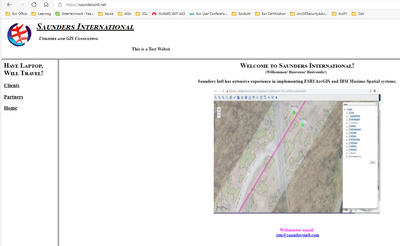

The website you see is installed on my SI-Server1. (Windows Server 2019).  IIS has the first "Default Web Site" at C:\inetpub\wwwroot and the second defined website is this "saundersintl.net" at C:\inetpub\saundersintl and it is my test website.  But I can not get SI-Server to join the saundersintl.net domain.

The domain is an alias that points to the server.  On the web prod machine you could use use https://localhost/portal/webadaptor yes you’ll get certificate errors but ignore them.  Then in the configuration you can enter si-server.lan and the credentials.  The web adaptor only needs to know about the internal routes to application servers.  Not the external Alias name.
