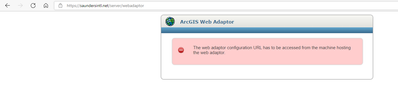

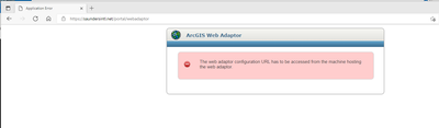

I think you're getting close in your web configuration because I can see this:
Which means you need to configure the web adaptors.  Given that you've used Enterprise builder, and it's all on one machine, then you should be able to use the SI-Server1.lan I mentioned earlier.
