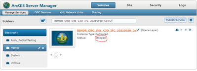

 Stop the services:

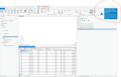

When add to Arcgis Pro:
Cannt add field with geoprocessing tool:
If anyone know where I went wrong and let I can update shcema of it?

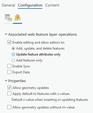

I have made it editable when publish it like below screendump:
I tested it immediately after published it, so  should have no lock on the schema.
