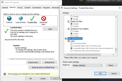

ChristopherPawlyszyn
A (sanitized) screenshot of what the login prompt looks like may be helpful to narrow down the behavior. If it's a browser challenge, I would recommend making sure that the FQDN (or DNS alias) is added to your Trusted sites (in Internet Options -> Security) and you have your 'User Authentication' for that zone set to 'Automatic logon with current username and password'. If you find these settings are not configured properly, your IT team should be able to push them via group policy instead of having to manually update for your entire organization.
Keep in mind this is a client-side setting, the setting on the Portal machine would only apply if you were using a browser on that machine. Another factor to consider is whether you are prompted from other machines or just from the Portal for ArcGIS machine, since that could lead to a different conclusion about what is causing the behavior.
