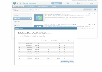

Hmm, I'm not seeing any job errors for getting the cache info in Monitor or in the Manager logs for the Hosted server.  I am seeing that my minimum cache level did not generate:
I should have a bundle at level 8 but I don't.  I generated the cache 'on-server' through pro 3.1.1 when I pushed the layer up as hosted tile layer.  The cache directory  . . . \directories\arcgiscache\Hosted_EffectiveFloodUpdateTile\EffectiveFloodUpdateTile\_alllayers shows that the level is missing as well.

I can report an update: I generated my missing minimum level 8 tile bundle, but that had no effect on the overview page.  The overview page still does not show in portal, and the Settings page remains greyed out.  Probably should have mentioned the settings page grey-out at the beginning of this thread
