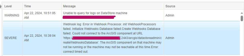

We have a multimachine ArcGIS Enterprise deployment and since last week we are seeing the below waning and SEVERE logs on ArcGIS Server Manager.
All the services seems to work fine, datastore machine is working fine as well, and there is no communication conflict between machines hosting server, portal and datastores.
Did someone encountered such logs before? What could be triggering this?

Hi @Yogesh_Chavan,
It looks like there may be a permissions error on ArcGIS Datastore which is preventing ArcGIS Server to read the logs of Datastore.

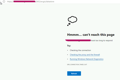

Yogesh_Chavan
Thank you @A_Wyn_Jones for you helpful insights.
To our findings we tried following your suggestions and observed that the server machine fails to connect to https://Datastoremachine.domain:2443/arcgis/datastore.
This works well in datastore machine for both localhost and domain URL.

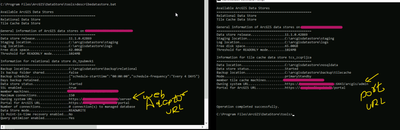

Adding some more info from the describedatastore.bat utility we observed that the machine with relational datastore's owning system URL is web adaptor URL whereas the other machine with tile cache datastore shows Port URL.
We have 2 datastores installed on separate machines, and the issue with errors/logs is in relational.
