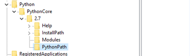

I've verified that registry has the right paths set for Python 2.7.
E:\Python27\ArcGISx6410.8\Lib;E:\Python27\ArcGISx6410.8\DLLs;E:\Python27\ArcGISx6410.8\Lib\lib-tk
