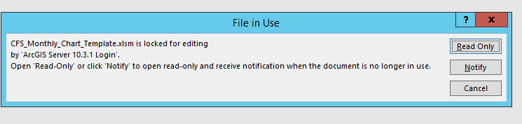

I changed the path of the Excel template from the scratchFolder to one of the g_ESRI_variable paths in the packageWorkspace. I ran the execute task and the Excel file was locked when I tried to open it. I got this message, even though Excel was not open in my task manager.
