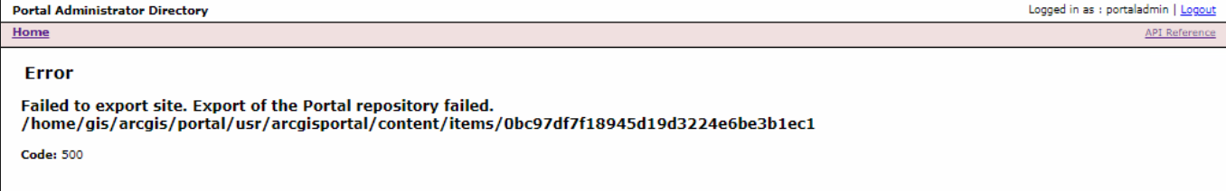

Hi All,
I have the same issue on ArcGIS Portal 10.6.1, however the folder it says doesn't exist,
/home/gis/arcgis/portal/usr/arcgisportal/content/items/0bc97df7f18945d19d3224e6be3b1ec1  is not the sub directory of the directory. This ArcGIS running on Linux. Need your help guys, thank you
JonathanQuinn
Esri Notable Contributor
Create the 0bc97df7f18945d19d3224e6be3b1ec1 folder within the /home/gis/arcgis/portal/usr/arcgisportal/content/items directory and the export will go through. Do this for any folder that fails.
