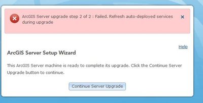

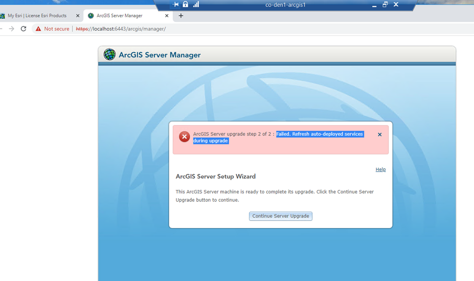

Hi Everyone! We have been attempting to perform an upgrade on our ArcGIS Portal & Server from version 10.9.1 to 11 over the past couple of weeks, and consistently encounter the following error message when attempting to finalize Configuring ArcServer.
ArcGIS Server upgrade step 2 of 2: Failed. Refresh auto-deployed services during upgrade
This occurs in both our staging and production environments. We have been working with ESRI Tech Support for the past 2 weeks to try and resolve what is causing this error to be thrown at the final stages of refreshing the auto-deployed services during the upgrade. There have been approximately 5-6 different solutions attempted by ESRI to resolve this error, which have been heavily focused on permissions and IIS configurations, but there has not been any success to date. We have been able to replicate the error across both environments with and without ESRI tech support's assistance. When researching this error, it has occurred in the past when upgrading from multiple different versions, but none of the solutions that have worked for past upgrades have not worked for the upgrade to version 11.

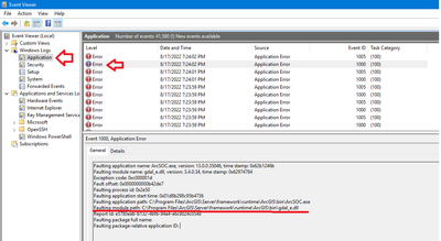

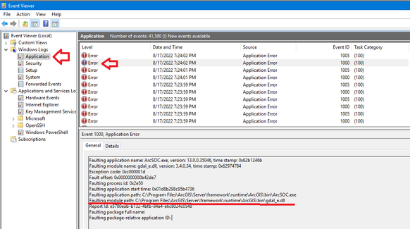

So it looks like my ARCSOC.exe's are crashing immediately after click the 'Upgrade' button. When I go to Windows Event Viewer it identifies a DLL (gdal_e.dll) in the ArcGIS server directory as the culprit.
Out of curiosity could you have a look at your windows Even Viewer the moment after the Upgrade fails to see if there's any errors mentioning 'gdal_e.dll'? If you have a similar error somewhere in there, we may truly be experiencing the same bug. You may have to sift through the Event Viewer, tends to have a lot of entries.

During the post-installation upgrade step, the web interface threw an error:

Then l had a look through Windows Event Viewer and found tons of application errors generated by ARCSOC.exe, with the faulting module gdal_e.dll.

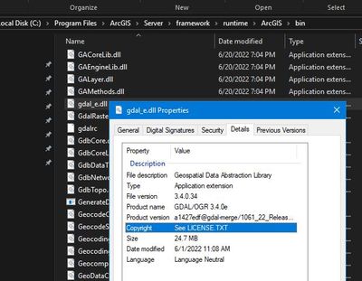

Had a look at the DLL file itself and it turned out to be a very newly compile version of GDAL.

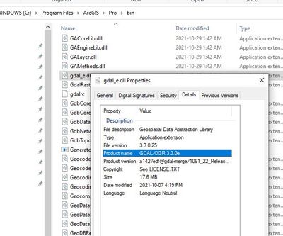

I decided to compare it to the DLL included with ArcGIS Pro 2.9.
Noting that it wasn't a major version change, I decided to risk it and replace the 3.4.0.34 version with the 3.3.0.25 from Pro 2.9.
After doing that, the upgrade completed successfully!
It seems that this particular build of the GDAL DLL 3.4.0.34 might have an issue running on our VM.
