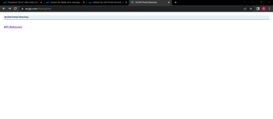

I know it's been a while since this has been posted. However, I have run into the same issue as the original poster. Every time that I try and use any form of analyzation within the ArcGIS online application, an error message displays which is blank. However, it seems to me that I cant quite manage to get to the sharing API as an administrator. I bought an ArcGIS private subscription, wherein I am the only administrator, and yet I do not have any of the options that you do when I navigate to the sharing API using your links:
I think that my problem is that I can't quite seem to understand what URL I would have to type to get to my API Sharing settings. What is my portal, my domain? Considering that I did not download anything separately, and am just using ArcGIS Online, I am slightly confused.
Could you help me out?
