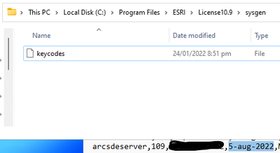

if you navigate to the keycodes file, and open it in a text editor, do you see one line that starts with arcsdeserver?  And what's it's expiry data/version?

DanaYoung
No I do not see that line at all nor a date.
Scott_Tansley
MVP Regular Contributor
So basically you haven't got a license for the Enterprise Geodatabase and need to take it up with your local Esri (or Distributor) licensing team.  🙂

DanaYoung
There was this line...
sdeworkgroup,109,ecp786258229

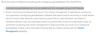

ah, so you're trying to create a workgroup geodatabase in SQL Server Express, and not an Enterprise Geodatabase.  Sorry, subtle change in terminology but it means quite a lot.
Types of geodatabases—ArcGIS Pro | Documentation
FAQ: Is it possible to create a workgroup geodatabase in ArcGIS Pro? (esri.com)

No need to apologise.  We all have to learn and I only know this because I've worked with ArcGIS Server since it's first release and the Enterprise Geodatabase before that.  Have a read of the doco, it's a shame we need to use ArcMap for managing the workgroup geodatabase though.  😞
