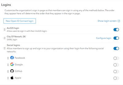

Hi Scott,  We authenticate using Windows and Active Directory.  In Enterprise, users can create their own built-in accounts now, that was turned off.  My AGOL screen looks like this:
If I place my Windows credentials in the script command line, the script authenticates, reads the CSV file, and then throws an invalid token error suggesting an issue with the geocoder.
