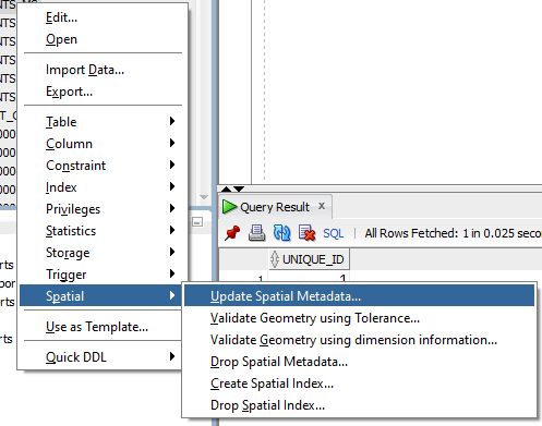

@JakeSkinner
FYI - I noticed just now that SQL Developer has a tool for entering Spatial Metadata for a given table:
That could be handy.
