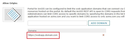

Are there any domains in Allow Origins under the portal security settings?
I've seen some quirky behaviour like this with the REST service directory in situations where domains have been added to Allow Origins but the ArcGIS Server domain is missing.  By default all domains are allowed, but if you add any to this list then the ArcGIS Server domain must also be included.
by Anonymous User
Not applicable
We don't have any domains there - maybe I should try adding the server domain just in case?
CraigRussell
Hi Mary
Its unlikely to have any effect because no domains listed = all domains allowed.  It isn't an issue to try out provided there aren't applications on other domains trying to connect to the ArcGIS REST API using CORS.
