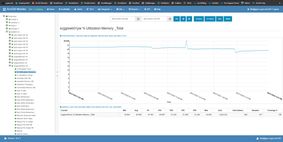

    Memory - the system requirements dictate that the 'web adaptor' now requires 8Gb minimum:
    Hardware requirements
    ArcGIS Web Adaptor (IIS) requires a minimum of 8 GB of memory, with more potentially required depending on the number of ArcGIS Web Adaptor instances installed and the number and size of the requests received.
    Does this mean 8Gb per Web Adaptor?  I don't know.  We are running 3 Web Adaptors on a 16Gb Windows 2016 Server with 4 cores, 8 virtual.  So according to the hardware requirements, we are under-memory.
    Yet we run about 20% memory utilization on the server day in and day out:
    So that's it.  I guess I "lucky?"  I don't know, but I do know more fine-grained info needs to be provided on this thread.
