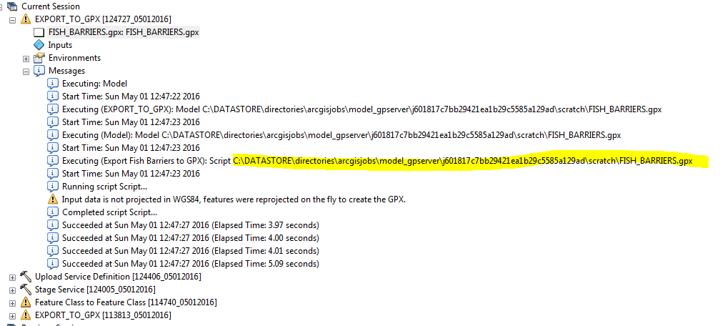

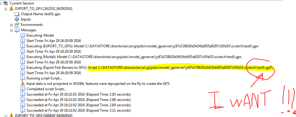

When I run the GP tool from the GIS Server connection in Arc Cat, I can see that the output GPX file is going to the jobs directory, but how can I get that file? The whole point of this is to have a simple-click-one-button tool so users can get a GPX file back on their hard drive.

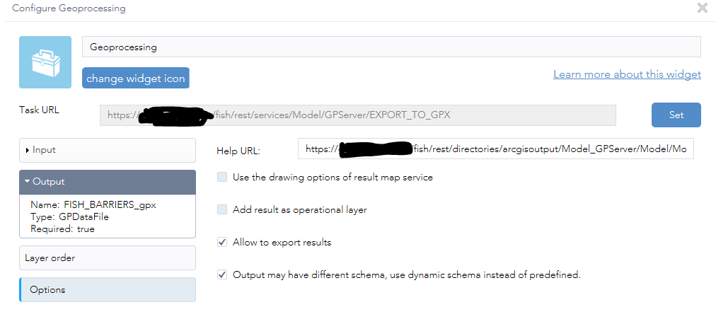

So I've modified the PY as such:
    inputFC = "\\\\server\DATASTORE\GP\\FISH_BARRIERS.shp"
    outGPX = os.path.join(arcpy.env.scratchFolder, OutName)
    zerodate = "#"
    pretty = "#"
    featuresToGPX(inputFC, outGPX, zerodate, pretty)
    arcpy.Delete_management("\\\\server\DATASTORE\GP\\FISH_BARRIERS.shp")
Re-ran the tool, republished it, same result:
Added it to a WAB (developer) GP Widget
Hit execute, same result: nothing.
Am I missing something elementary-obvious or does this workflow only work with the export-web-map-to-pdf task example?

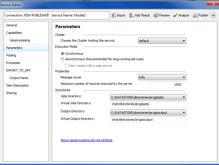

Update...implementing some of your answer, setting the job to asych, and setting "add to display" in the model solved this. You can infer I spent ALL WEEKEND ON THIS.....
