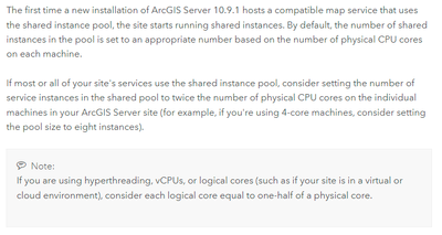

The first time a new installation of ArcGIS Server 10.9.1 hosts a compatible map service that uses the shared instance pool, the site starts running shared instances. By default, the number of shared instances in the pool is set to an appropriate number based on the number of physical CPU cores on each machine.
If most or all of your site's services use the shared instance pool, consider setting the number of service instances in the shared pool to twice the number of physical CPU cores on the individual machines in your ArcGIS Server site (for example, if you're using 4-core machines, consider setting the pool size to eight instances).

I almost concur with the other comment on this.  But you must pay attention of the 'Note' beneath.  Effectively, if you're using physical machine then double it, if you're virtualised it's one for one.  Most of my clients use 8vCPUs and so we set this value to 8:

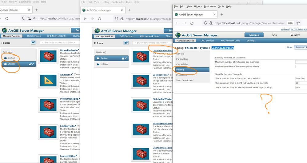

I couldn’t figure out why the number of cached map services need to be set in 10.9.1? Why not having all types of services consuming from all shared instances (cores)?
This is in addition to the fact that system and utilities services can’t be set as shared!

I am making guesses here, but for the case of ESRI Utility and System tools, these are set to dedicated as they may be requested internally by services on your ArcGIS Server machine and/or as part of ArcGIS Pro/ArcMap - a requirement by the software.

My point here is that the two types of pooling (dedicated\shared) need to be available for all types of services, and it’s the choice of the admin where to go
