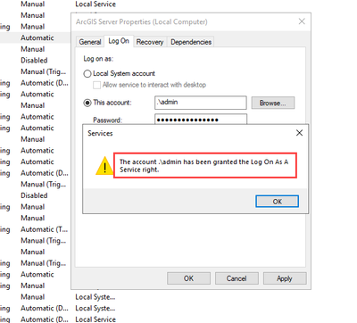

The clue to what is going on is what pops up when I manually re-enter the password for the ArcGIS server service user account '.\admin', as one of us always has to do after Windows server updates:
​Th​e obvious implication of the above dialog is that shortly prior to this point (but after the Windows Server updates), the account​ '.\admin' (the ArcGIS Server service user account), was NOT granted the 'Log On As A Service' right.  So​, before re-entering the ArcGIS Server service password, I checked the Local Security Policy, under ​Local Policies and User Rights Assignment.  Sure enough, the ArcGIS Server service account, '​.\admin', is not in the list of accounts that can log in as a service.
​After re-entering the ArcGIS Server service password, a recheck of the Local Security Policy as above now shows that the ArcGIS Server service account 'admin' is in the list of accounts that that can 'Login As A Service'.  In our case, this change cannot be done manually here, as the option to 'Add User or Group' is grayed out.  I had to re-enter the password in the service dialog in order for the account to be re-added to the list that can login as a service.
