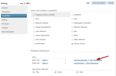

Or you can do this from server manager here after selecting the layer:
To me this appears as if it is a warning, but as I saw in your other message that it crashes above 4000, that could be a larger issue. I would recommend reaching out to Esri support as well to get a case started with them too!
