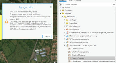

hii,Hello, I have the same problem, did you find a solution?

Did you guys find a solution?
I have the same problem with ArcGIS PRO 2.9.5
A few weeks ago it still worked.
