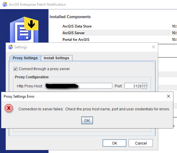

we are using the ArcGIS Enterprise Patch Notification tool on several servers, which all connect to the internet via the same proxy server.
Now we have one new server where we get the error "Connection to server failed.", when we try to apply the used proxy server host and port in the settings of the tool:

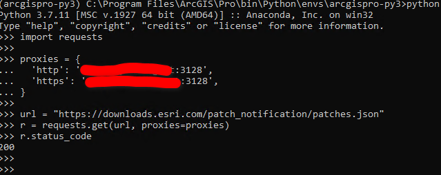

This only happens on this one server and the interest part is, that connecting to the internet via the same proxy server works on this machine in Python:
Also in the Edge web-browser it works fine, only inside the Patch Notification tool we are not able to connect to the proxy server 😞.

I found the problem, it was our fault:
We forgot to import our Root CA certificate under /arcgis/portaladmin/security/sslCertificates.

that's also what I thought, but what speaks against is the behaviour that running a cmd with the same user and performing a curl get or requests get in Python with the same proxy settings works fine!
