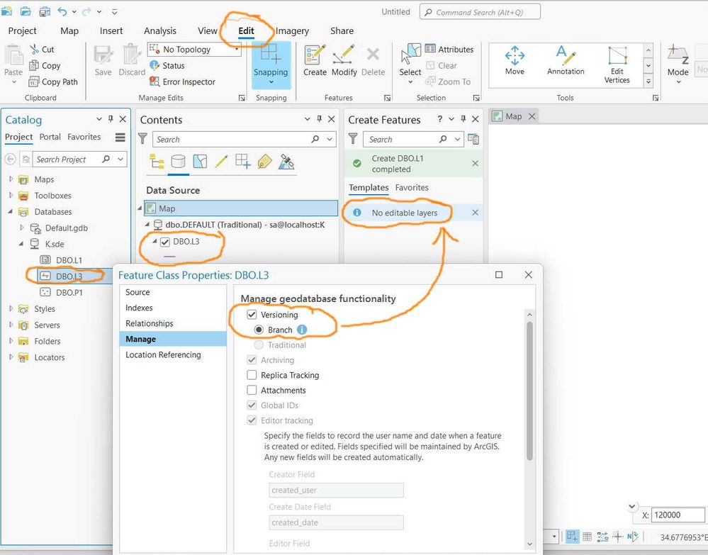

I couldn’t figure out why versioned feature classes with “branch” type get uneditable
Is this by design?

Hi Jamal - pretty sure this is by design.  You have to edit a branch feature through a feature access connection after the layer(s) have been published to portal
Scott_Tansley
MVP Regular Contributor
Branch editing is only available via a published feature service.  The data becomes read only in a Pro to database connection.
basically a web service controls the versioning process and so the editing has to be via a feature service as well.

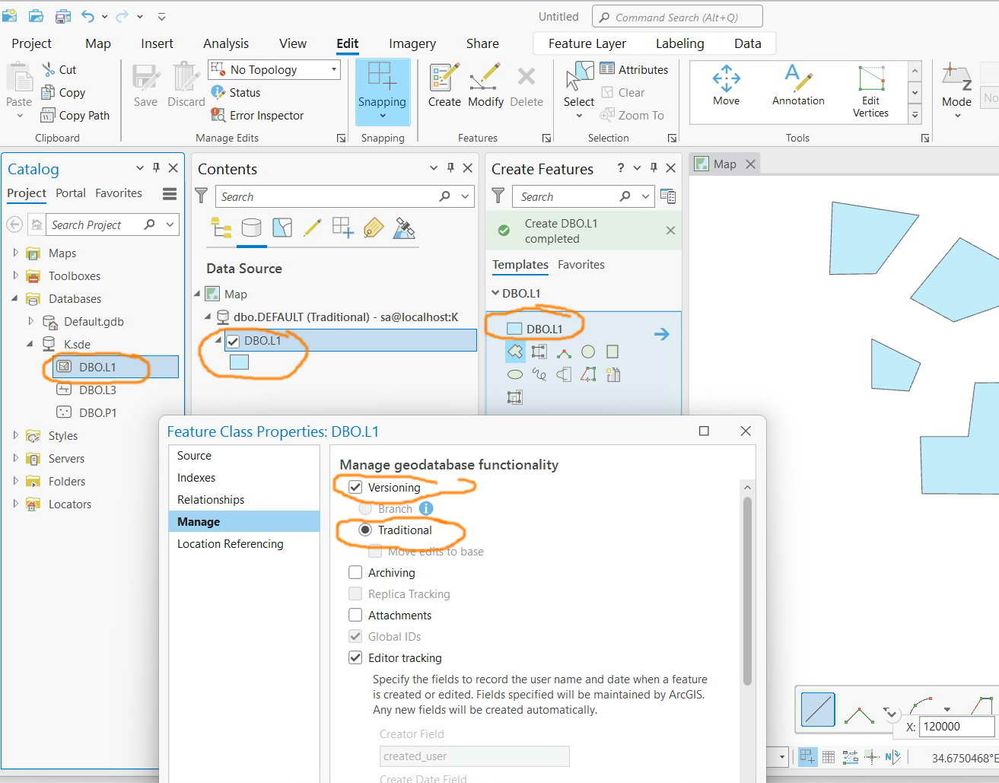

In other words: what I lose if I go for traditional version and publish the feature classes as feature service? This way, editing is still possible either from feature class or feature service.

Branch Versioning is designed for optimum performance.  Versioned Editing is 'highly functional' but recognised as being slow.
Publishing with Feature Access on Traditional Versioning offers up numerous options/complications (in my opinion) which serves some end use cases and not others.  Branch Versioning is much more simple to publish and "just works" with supported client applications.
