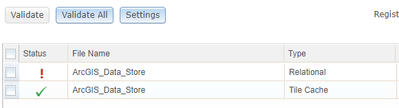

I've got a simple all-in-one enterprise portal setup for development/testing but the Relational data store won't validate.
Thanks for any suggestions.
From the datastore config wizard:
From the server manager:

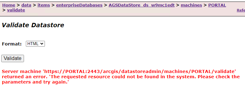

From the server rest admin:

WARNING Sep 14, 2023, 1:54:18 PM Failed to validate the data store machine 'PORTAL'. 'Server machine 'https://PORTAL:2443/arcgis/datastoreadmin/machines/PORTAL/validate' returned an error. 'The requested resource could not be found in the system. Please check the parameters and try again.'' Admin
