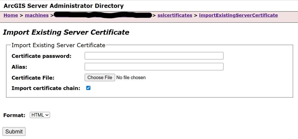

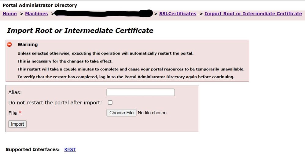

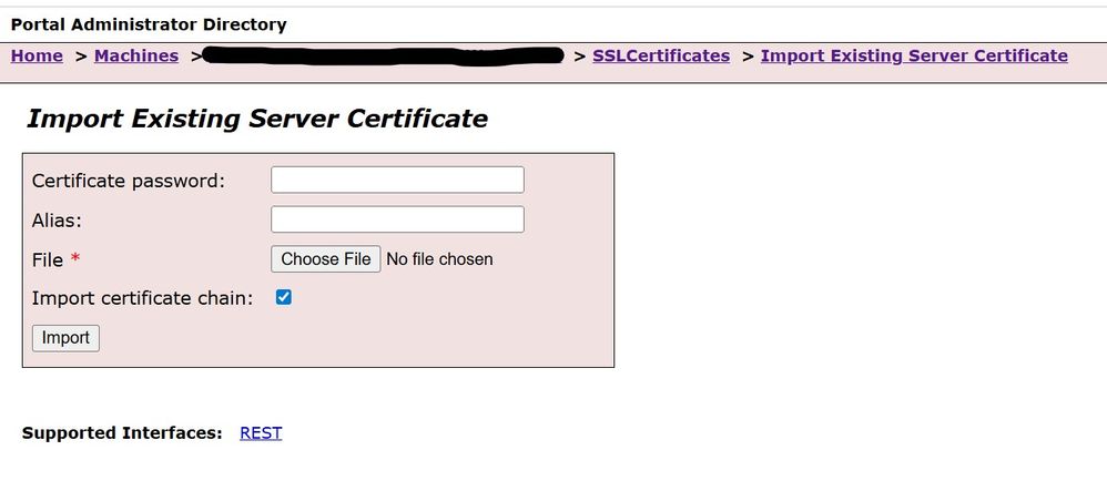

I can confirm that I am using the same pfx for all the machines, when I am installing it by double clicking on it and when I am importing to ArcGIS Server and Portal. How I am importing are shown in the following screenshots.
Root and Intermediate Certificate import into PortalRoot and Intermediate Certificate import into PortalImport Server Certificate into PortalImport Server Certificate into Portal
Import Server Certificate into ArcGIS ServerImport Server Certificate into ArcGIS Server
