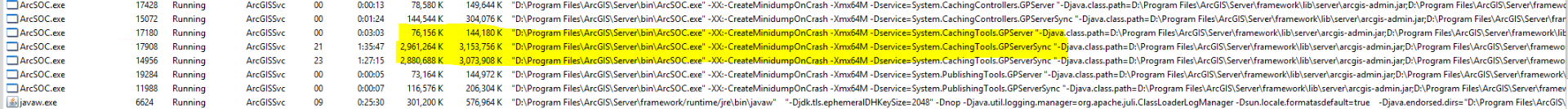

i currently have the server set to a max of 2 instances of CachingTools. the two instances of .GPServerSync are crippling our machine! i have never seen this behavior before and the only thing that has changed on our machine is an upgrade from 10.2.2 to 10.5.1
Machine Specs:
Windows Server 2012 R2
16 GB Ram
Intel Xeon CPU E5-4620 v2
 thoughts?
