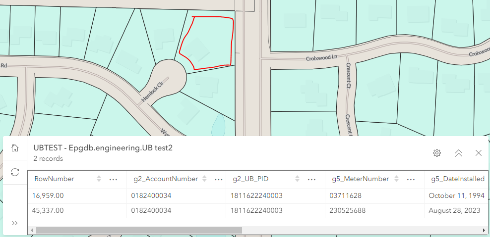

What it should do is search the table UB_Test_2 for all the rows that have the same g2_UB_PID and return meter information. Here's an example of the test 2 table. The identified parcel is the parent feature, and the two records shown in the table both have the same PID:

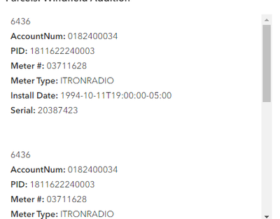

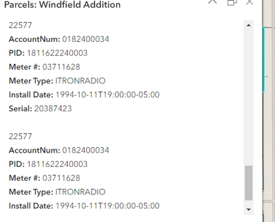

However, running the expression above, only one of those two records is returned, and it is retuned twice:
This persists across all features, where the number of possible related records is returned, but only information from one of the records populates all the returns. As I mentioned, essentially this same expression (different datasets and just different fields used in the filter and return, with the same expression structure) works just fine.

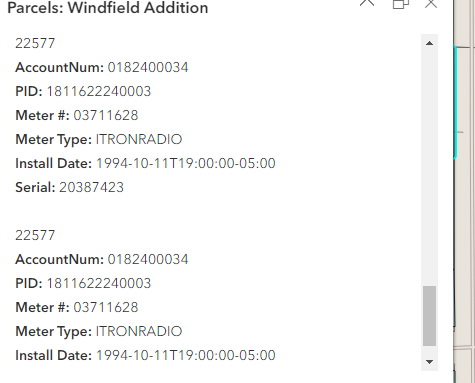

Not a real relationship, just a shared field. Curiously your expression did the same thing, but with a different row, even though I left the Sort variable alone:
