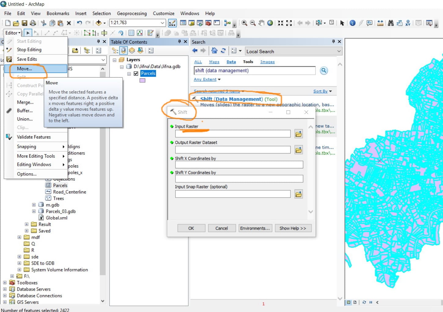

I couldn’t figure out if there is an equivalent shift tool for vectors as the one available for rasters. I’m aware of the “move” tool available in the editor toolbar, but what I need here is a tool that can be added to the model builder
Thank you
