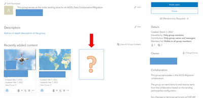

Ok, so I am properly stumped... I have set up a collaboration between my Org AGOL account, and Enterprise Portal. I am attempting to bring all content shared with my AGOL collab group over, but 1 Item never comes over. The sync says it succeeded, and no errors are displayed anywhere, but I am always missing the 1 item. Everything else works perfectly... What am I missing?
Note: Item is very large (9GB) and has a ton of attachments.

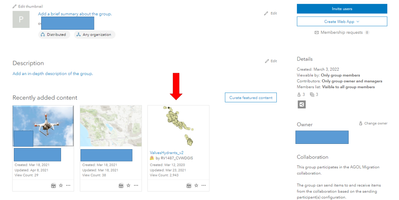

Royce_Simpson
After setting up one-way dist collab (DC) between my Enterprise system and our AGOL site, I was able to get one test layer to sync but the second, larger one, failed.  I couldn't find any helpful messages, just a "1 of 2 failed" message on the guest DC settings page.  I believe that I am running into this 1 gig limit.  Is there any way to know that for sure?  Any more detailed messages that I can look at?  Also, is there any way to remove that limit? It's going to make our attempt to use DC dead in the water.  Much thanks for any response.  If there isn't a way to get around the 1 gig limit, who might I be able to talk to figure out why this is in place and what can be done in the future to override it?
