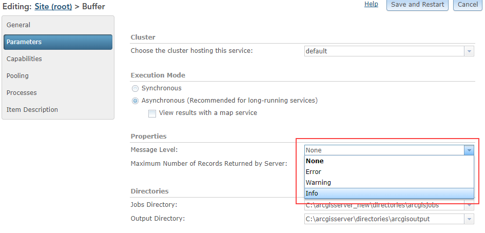

You can increase the messaging level of the service through Manager after it's published, or the service editor prior to publishing:

Does this work? I have tried it on my tool, saved and restarted the geoprocessing tool but the messages are still not showing. I used the arcpy.AddMessage function and then select "Info" in the Message level box.

I am using arcpy.AddError function and then select "Error" in the Message level box. It works for me.
adminCentlec
Thanks, I finally got some information returned but it only apppears for a split second and then it is removed once the tool is complete. Isn't there a way to write to the output pane of the GP tool using arcpy messaging levels?
