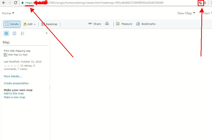

I've installed Portal for ArcGIS Server 10.4.1 and added a CA certificate to it, the portal is working very well and can consume https services from ArcGIS Server. However, when I try to add non-https services, it fails to load them and the unsafe content icon appears, so I need to click it in order to proceed.
Is there a way to enable mixed-services mode (http & https)?

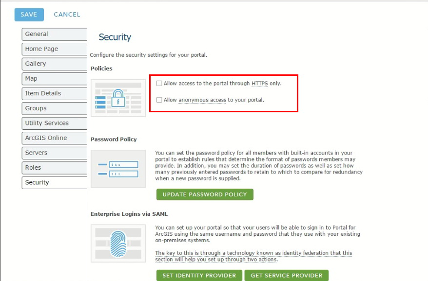

  • "Allow Access to the Portal through https only" is UNCHECCKED
  • "Allow anonymus access to your portal" is UNCHECKED
The Unsafe Content icon after adding http layer:

Mixed mode problems aren't necessarily a Portal issue, but a browser issue.  Browsers are designed to warn users of mixed mode content.  I'd suggest avoiding that problem altogether by being consistent with the protocol you use.  If you have secure services that require logging in, just be sure you create and access the webmaps over https.  If they're not secure, you can create and access them through either protocol.

Portal by default can be reached through http or https.  Login pages are always https, but My Content, the map viewer, groups, etc all can be reached through http, (as long as the option to only use SSL is not checked).
