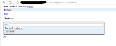

The machine where ArcGIS Portal is running may not have a connection to your WMS endpoint - this can be checked by using the checkURL function of Portal.
The URL may need to be added to the allowedProxy list or you may find there are some connectivity issues to the URL.
